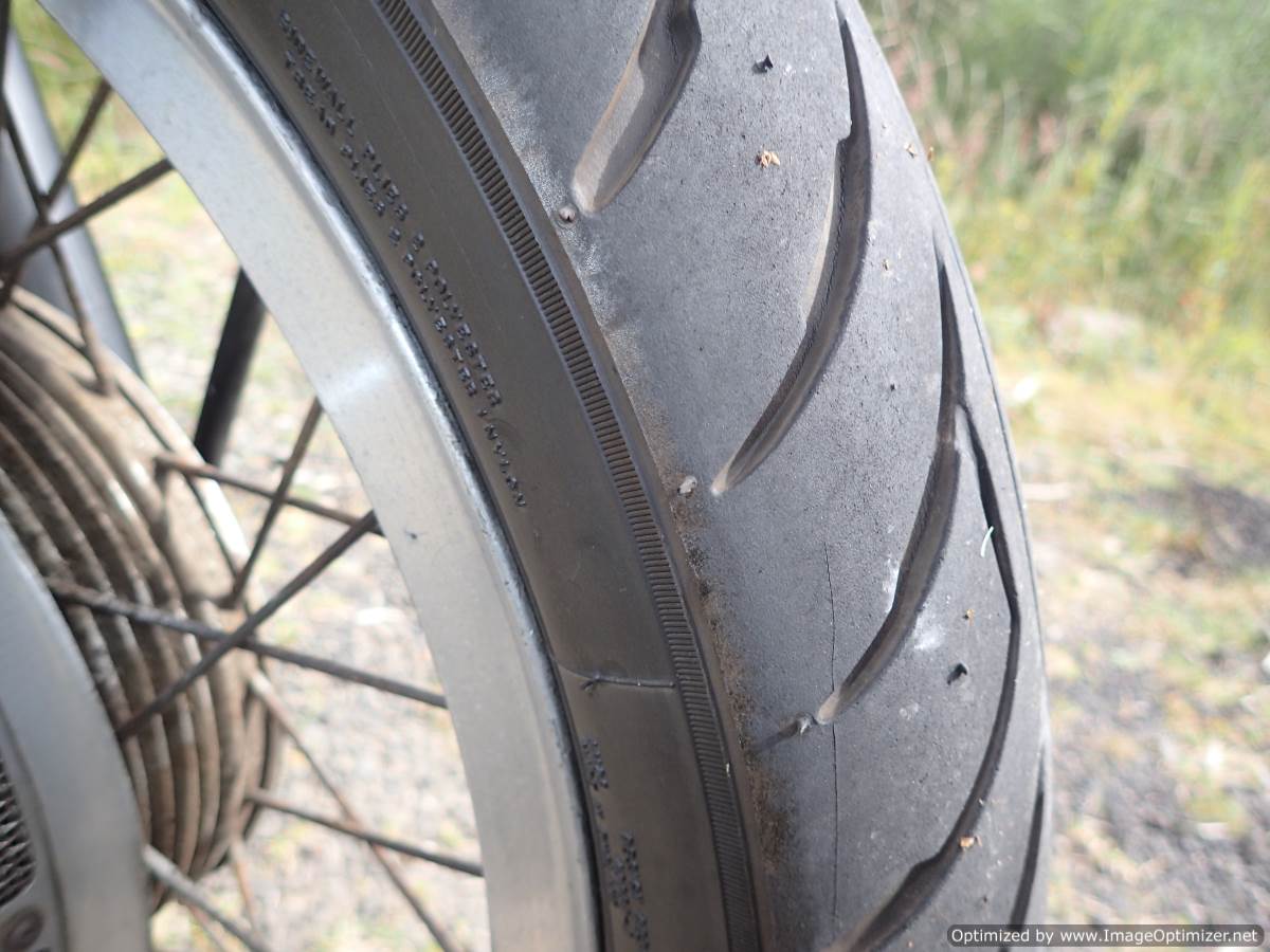

This photo is of my rear Avon Roadrider 110/90V18, fitted to my Mk3 Commando in 2016, date code 3014, and having done just under 4,000 miles. A large proportion of that mileage has been two-up and I normally use 35psi with a pillion (30 psi solo). However, we have just returned from Spain and 400 miles of almost constant bend swinging, and I know the pressure was only 33 psi.
My surprise is the very odd wear pattern seen by the placement of the rule on the shoulder of the tyre. It is like having triangular blocks on the shoulder and it makes me question the grip level when leaning over.
Anyone seen anything like this?
Not sure but car tyres wear…
Not sure but car tyres wear like that when the wheels are out of alignment. Never seen it on a bike though, have you checked your wheels are aligned?

When I raced bikes in my …
When I raced bikes in my 'yoof', the tread blocks always generated a step like that. Even today the tyres on my Morini wear like that when I'm in having a good thrash.
Personally, I wouldn't worry about it- the tyre was maybe loaded more than usual and was perhaps a little hotter as well.

Oh I see …
What George said – I've never raced, but I've thrashed – that tyre wear looks pretty normal to me, for a tyre that's been thrashed, I wouldn't worry about it. I don't now anyway, because I don't thrash any more …
I think...
This is what is known as "saw tooth" wear, more often seen on tyres with fairly large tread blocks as you have. If you often indulge on spirited acceleration, it makes the leading edges wear faster. If on the other hand you brake a lot then it's the trailing edges that suffer.
Looks perfectly normal to me…
Looks perfectly normal to me and my rear tyre (Roadrider) looks exactly like that, but I do like to crank it over and use lots of right hand.
Have a look at any super bike's rear tyre where the owner likes to give it some and you'll see exactly the same.

Nothing unusual there, considering the age, use and mileage on the tyre it is doing well. One thing I have noticed is that the Roadrider does not age well, most would not see 5 years old let alone 2, you can check with a relatively new one fitted to fellow members bike to see how the hardness changes with time.
Just noticed
The tyre is well on its way out, look in the centre groove, check some of the side channels, the cracking is age related.
Thanks for the comments all…
Thanks for the comments all. I like the description 'saw tooth'. I have seen it in the past on race tyres that were under pressure and getting too hot. Not sure my pillion will agree that I had been 'thrashing it' though :-) For sure it was under inflated at 33psi, the bike was heavy, and I tend to put a bit of throttle on from the apex of dry bends. Bob's observations agree. I am guessing now that it should have had at least 38 psi.
The sad news is that the tyre let go on a nasty, wet, polished RH bend in Spain last month and left us both sliding into the grass at 35MPH or so. Twenty other bikes went through OK, two others came down, probably distracted by seeing us in front. But, I take full responsibility because if I had been going 5MPH slower it would have been fine, etc., etc. What did get me thinking was the Triumph in front that I was following had an Avon SM rear. Huh, new generation tyres!
Ashley I agree it's due for replacement, but this is at 4,000 miles. There are no signs of the notorious AM26 deep cracks, but the rubber is prematurely hardened. Made in 2014, first used in 2016 and cooked to a hard rubber in 2019. That is not a good rubber compound.

I am thinking I have cooked my rear AM26 running it at 33-35psi two-up. The premature wear, saw-tooth profile and hardening at just three years all point to this. Thank you Alan for your report that 40psi front and back has kept your AM26 Roadriders working through heavy, long distances. That is valuable feedback for all Commando two-up travellers and worth printing in Roadholder - "you need 40psi in Roadriders two-up on a Commando as 35psi is not enough"!
