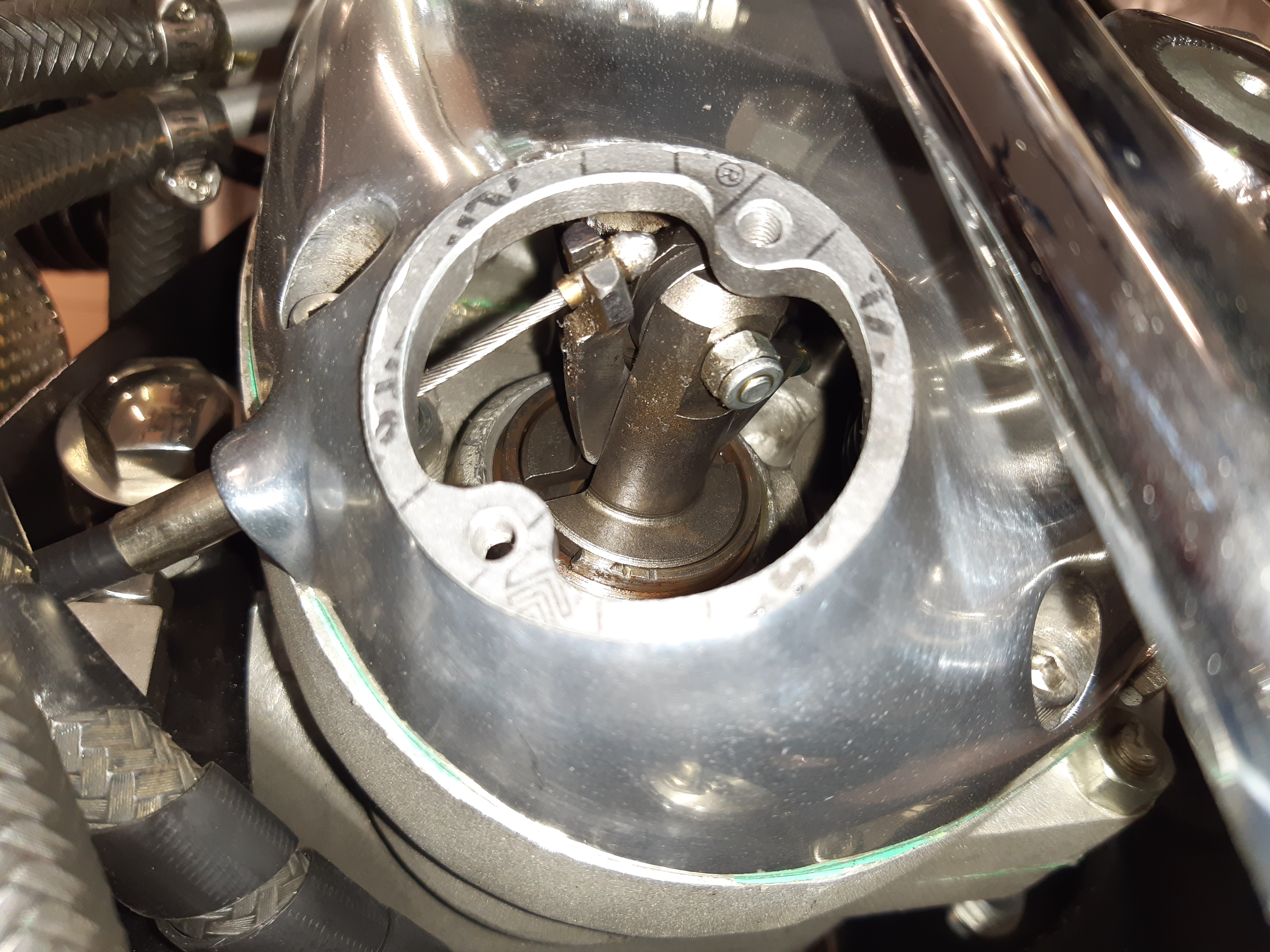

A picture tells a thousand…
A picture tells a thousand words, get your lever into this position, slack off the clutch adjusting nut to be able to get the lever aligned correctly.
Well, of course it was the…
Well, of course it was the lever that had slipped down out of position, now sorted! As I said, I was fooled by the fact that even in that position it was moving the clutch operating rod, but obviously not enough and without any force.
