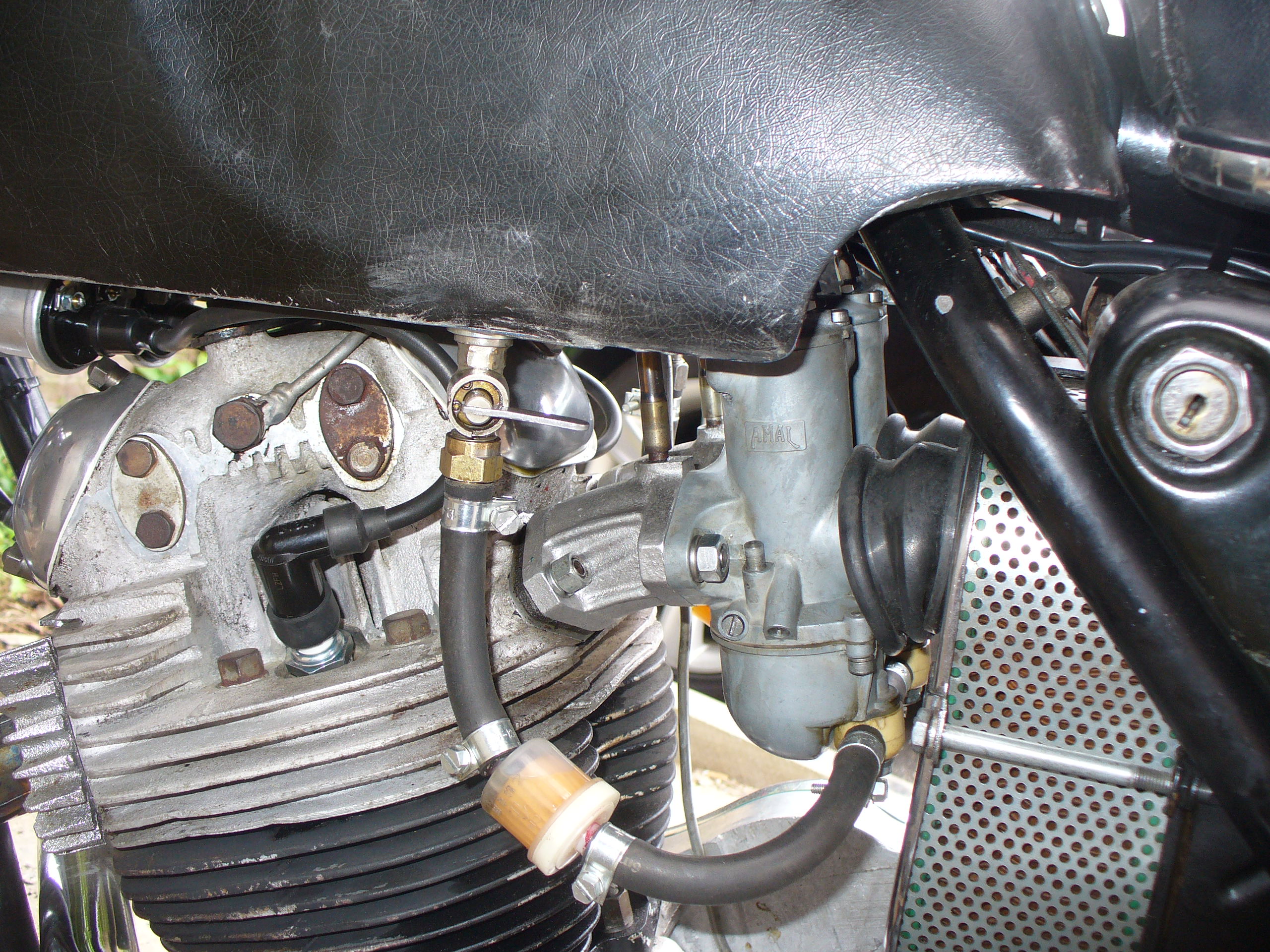

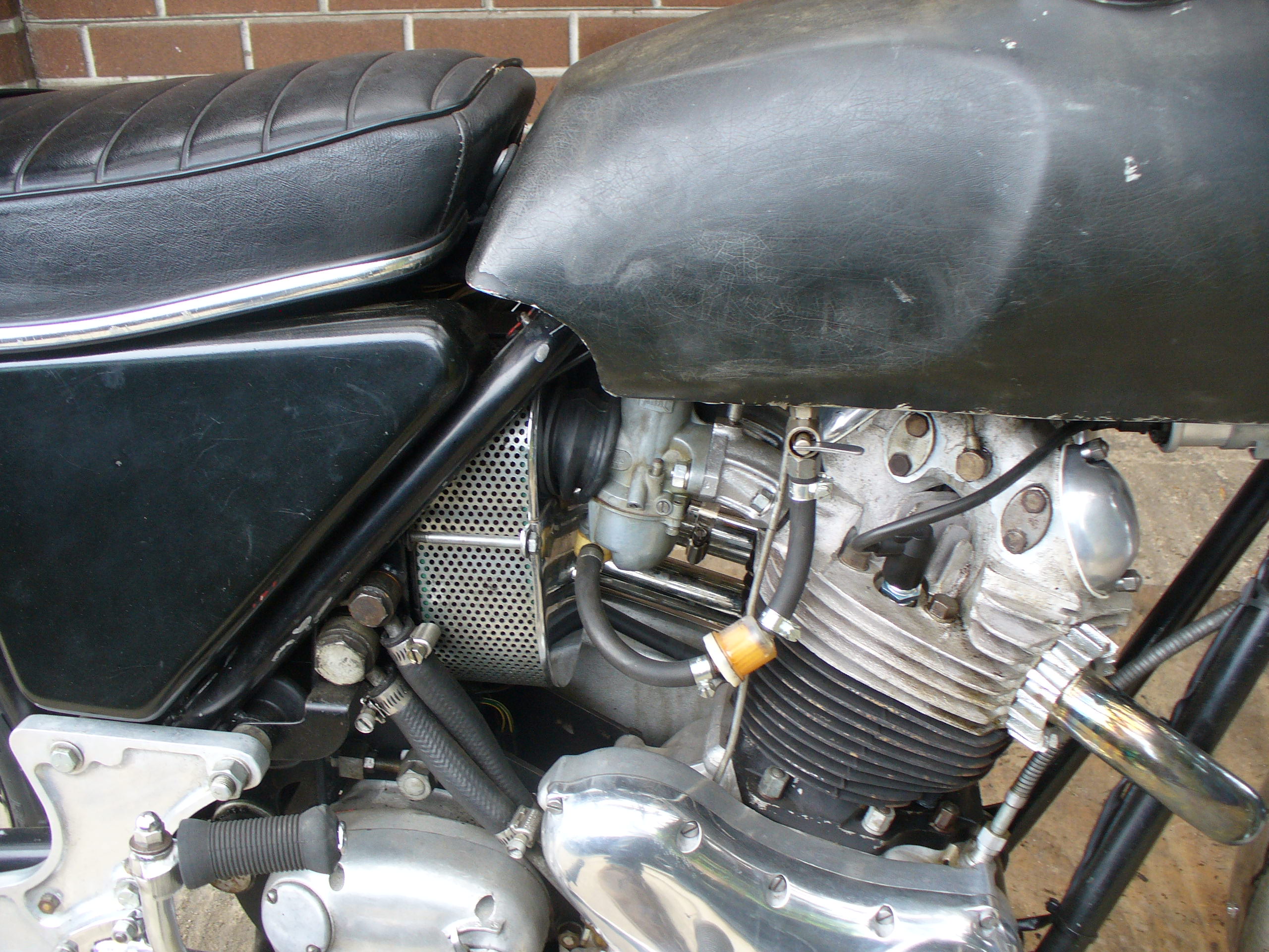

Found a clogged fuel line on the reserve hose just past the reserve tap before the in line filter so good to sort that.

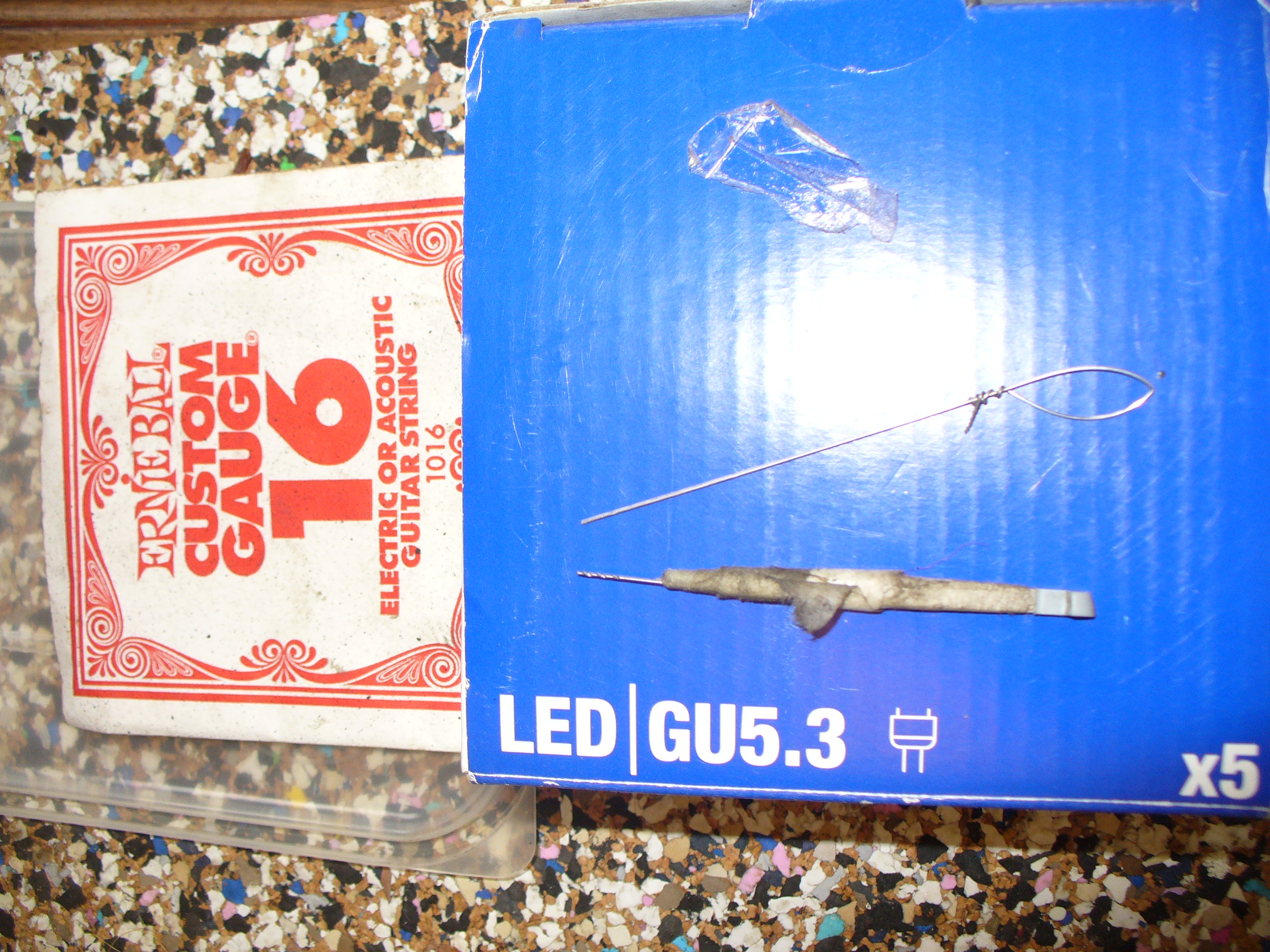

Credit to a previous post by John Holmes.....Smoking gun seemed to be the idle mixture jet. Removed idle screw and cleaned out with #79 drill and a guitar string then a big squirt down the hole with carb cleaner. Could not see any crud on the drill or string but I'll tell you what...quick blast up the road and it seems to have cured it completely. Now runs and idles fine. I'll pack them with my tool kit.
