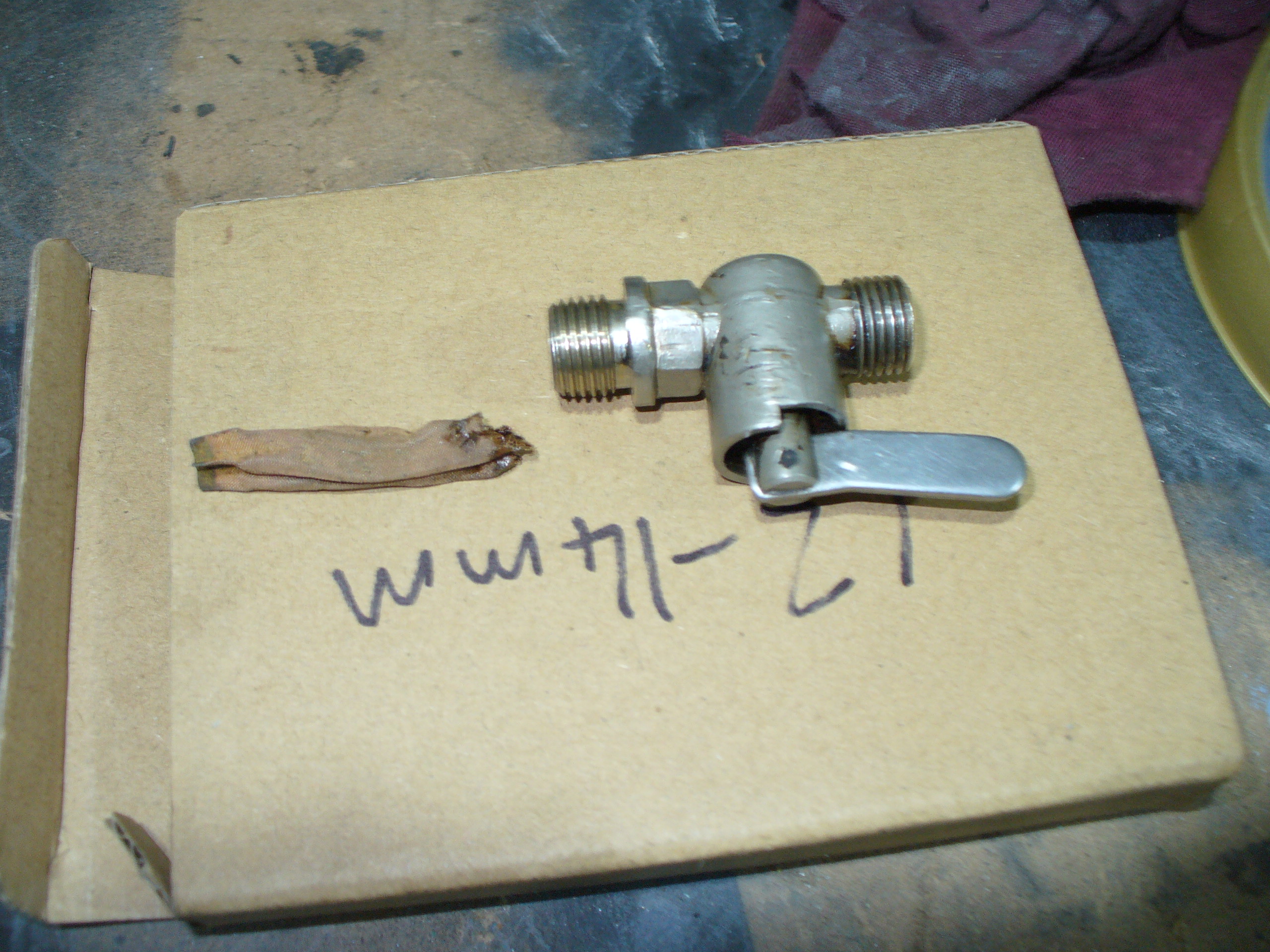

Hi,
Is it possible to buy a new filter gauze to the petrol taps and fit them?
I destroyed mine trying to get the gloop out.
Eddie
Solder but best with new brass filter, I myself would put those in the spares to be repaired box and fit new ones. You look to have the nylon shaft on the lever which is prone to snapping as the tap becomes stiffer to turn, if so then bypass the repair box and straight to bin.
