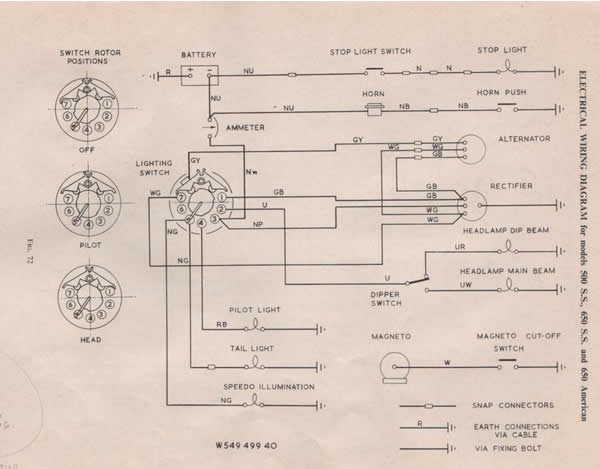

Fitting a Podtronic on a 650SS. All the instructions says it's simple!
My alternator has three wires. Currently the green/yellow goes to the the bullet connector at the top of the sprung caliper thing on the switch. Instructions say that this wire now connects to one of the yellows on the Podtronic. Can I/Do I now forget that particular connection to the switch?
I understand that the black wire from the Podtronic (+ve earth bike) will connect with the old Brown/purple off the rectifier which goes to switch connector position 3  which in turn goes to the battery via the ammeter. That one is fine.
However, one of the double green/browns off the old rectifier goes to switch connector position 1. Does this connection get scrapped or do I need a double connector off the new podtronic yellow to run a replacement wire to switch connector 1?
Lastly, one of the double white/greens off the old rectifier goes to switch connector position 7. Again, does this connection get scrapped or do need a double connector of the second of the new Podtronic's yellow wire to run a replacement wire to switch connector 7?
Sadly none of this covered in the instructions. Any help gratefully received.
Wiring diag attached.

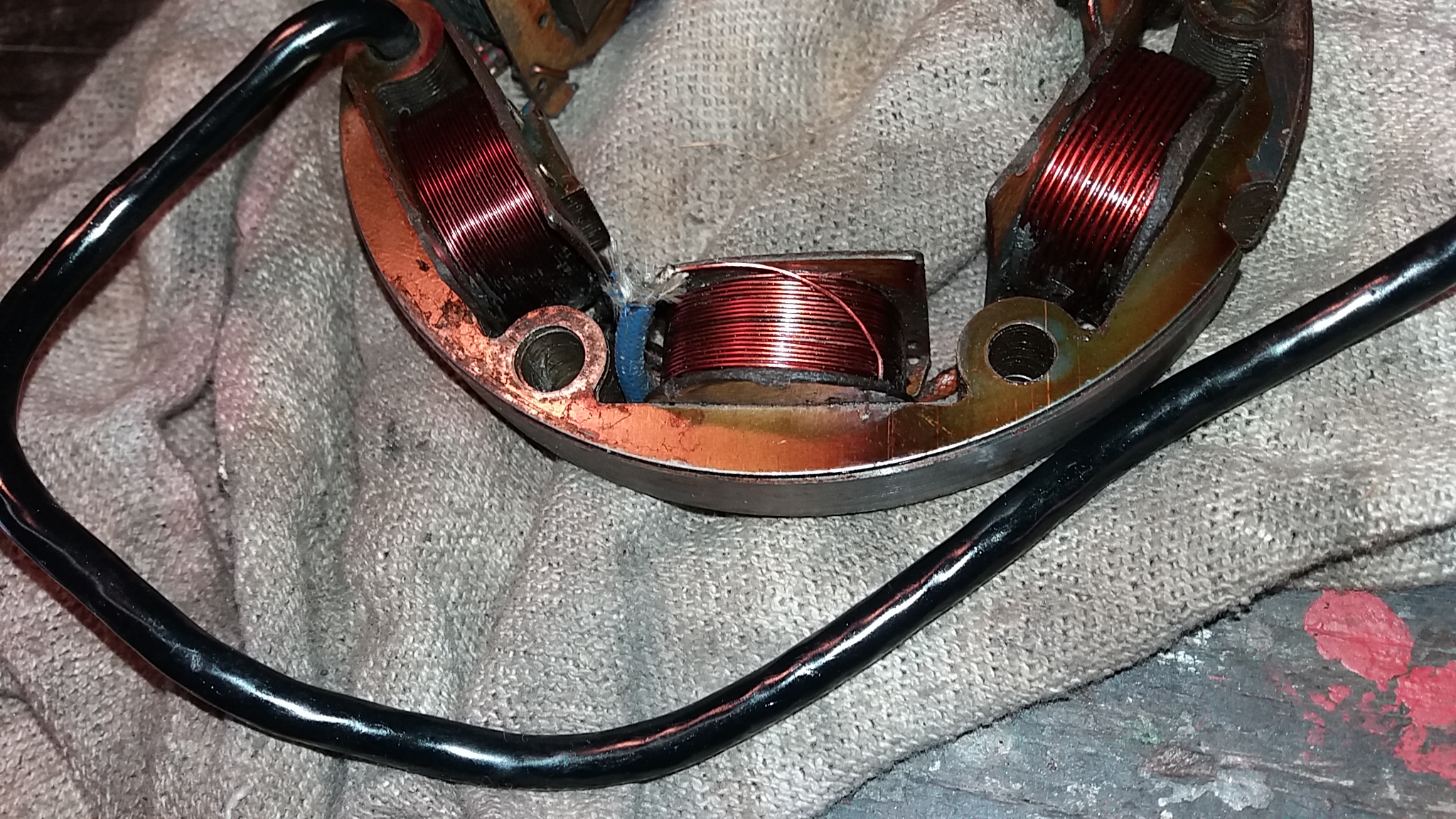

the 1961 ES2 I bought for rebuilding has 6 coils of which 4 have thick wire and fewer turns, and 2 coils have fine wire and many turns. I have been told that Norton never used this system, it is an old system with HV voltage for quick starting.
The stator has now been installed with 2 pairs feeding a battery and the coil. The HV windings are not used.
Now, there is no charging - even with no consumers on other than the coil, until about 35 - 40 mph in top gear. Around town the battery will go flat.
Not realizing that the '61 ES2 was 6V, I have fitted a 12V battery. It has a Wassell control box/rectifier fed by 3 wires from the stator, the fourth wire is not connected.
To improve the charging, should I have the HV coil pair rewound as the LV coil pairs are, or fit a 6V battery, or anything else that someone cleverer than I am, can suggest?
