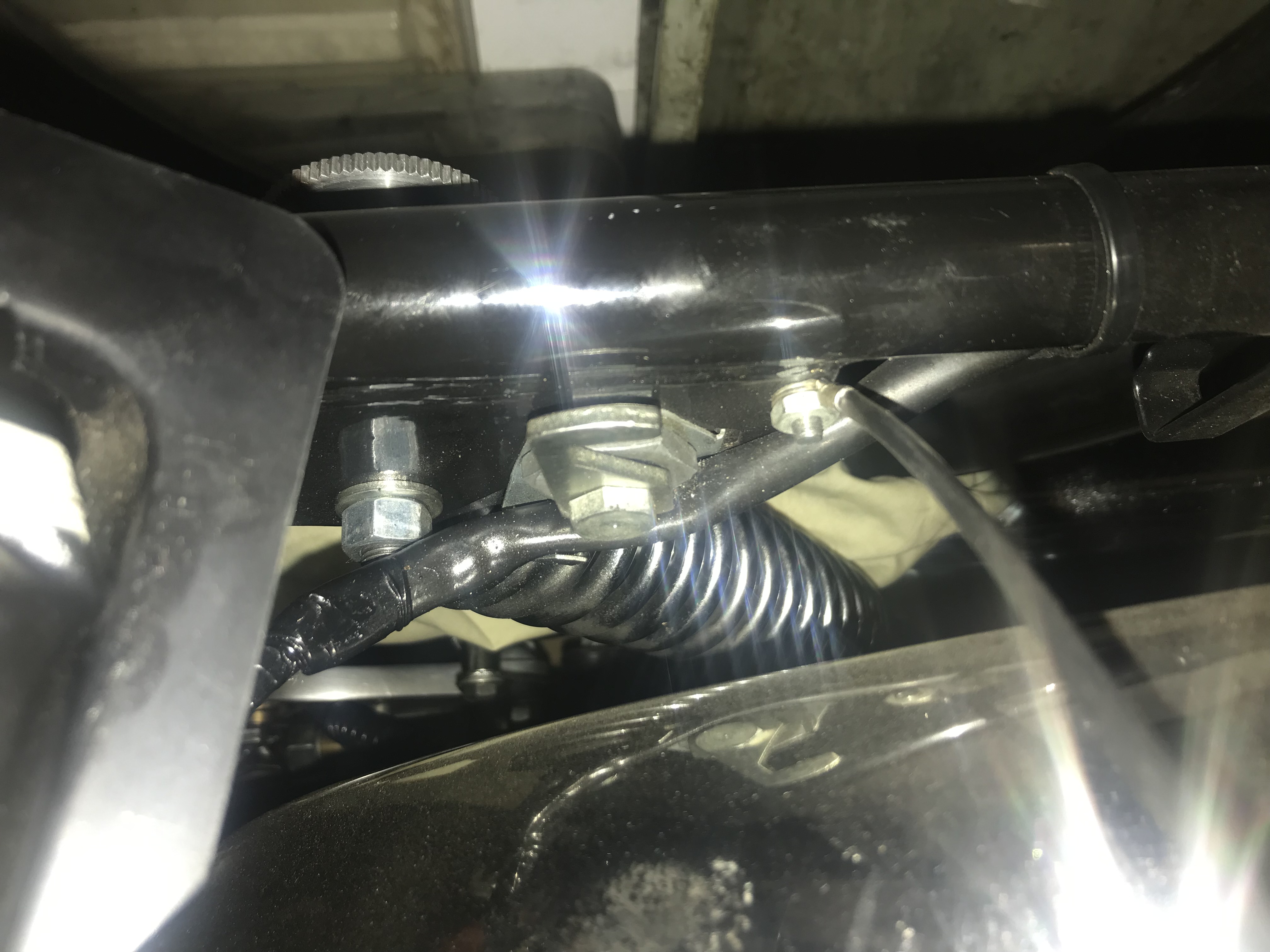

A threaded hole sounds incredibly sophisticated. I'm pretty sure Wolverhampton used a self-tapper. I have a couple of original bases. I'll take a photo tomorrow.
Richard, the parts catalogue lists a screw that the A-N listing shows as self-tapper, do your memory seems accurate!!
Self tapper with a washer into seat base, hex screw and nut with washer as per AN parts page through shock/lock mounting.
I think this is an original interstate seat base as it has a dog leg in the hinge mounting plate to clear the screw heads which the pattern ones don`t seem to have.
seat base
shock/lock mounting
seat hinge
Regards, Al.
