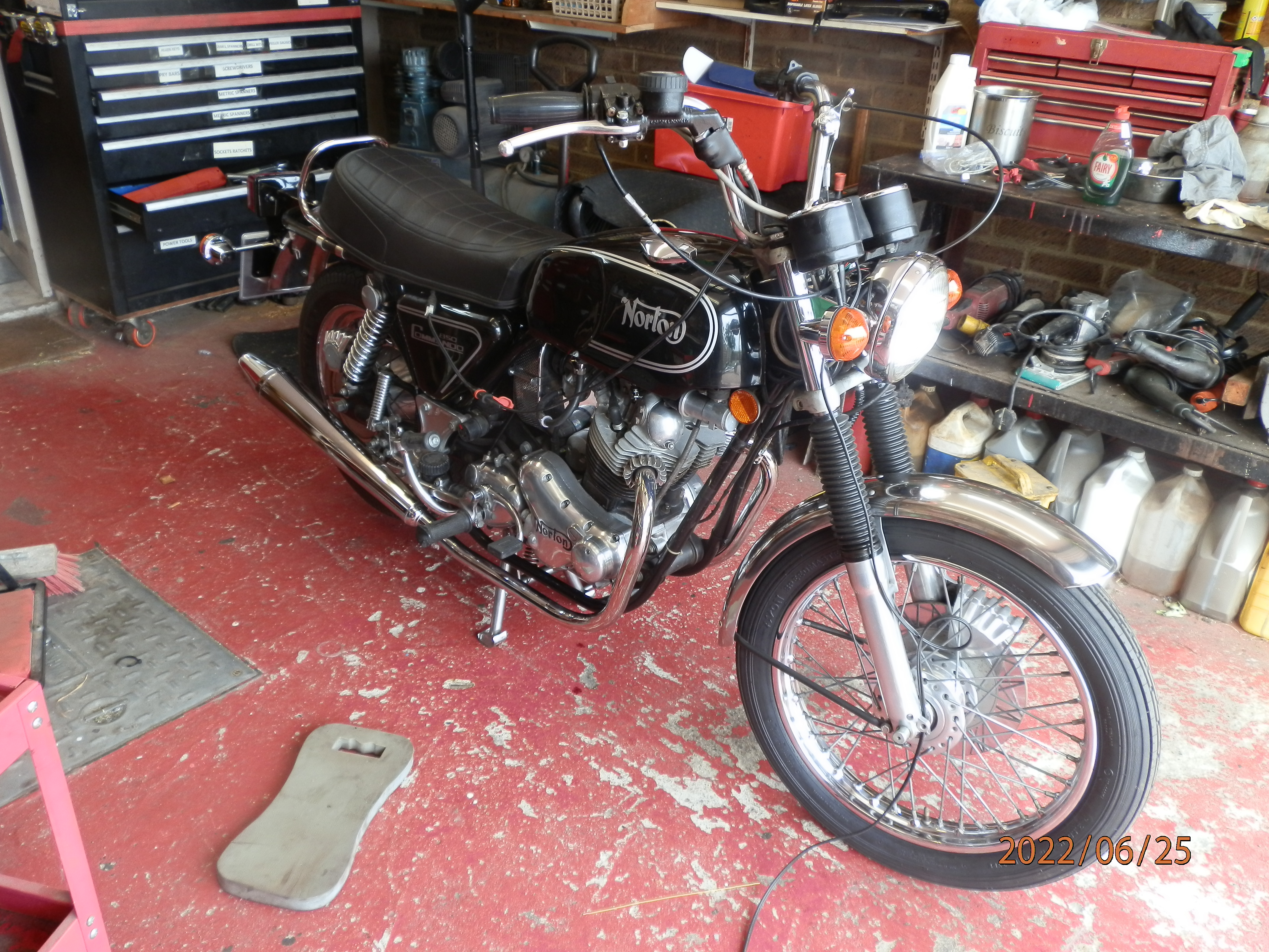

Hi again everyone more problems with my bike in the title, for some reason the ignition warning light is staying on, since getting the bike a few months back and during this time until now the light was going out as it should with a slight increase in revs, that is with a new high output single phase stator, and new podtronics regulator and rectifier replacement system, last week it has started staying on regardless of revs, I am suspicious of the WLA (Warning light assimilator) which I have been told can be a problem the bike is fitted with the solid state one of these being a Mk3 so I have ordered a new one just in case but would welcome any advice to cure this my friend who is quite well up on auto electrics assures me the bike is giving out a charge but cannot find out why the light is staying on many thanks for your replies Chris
