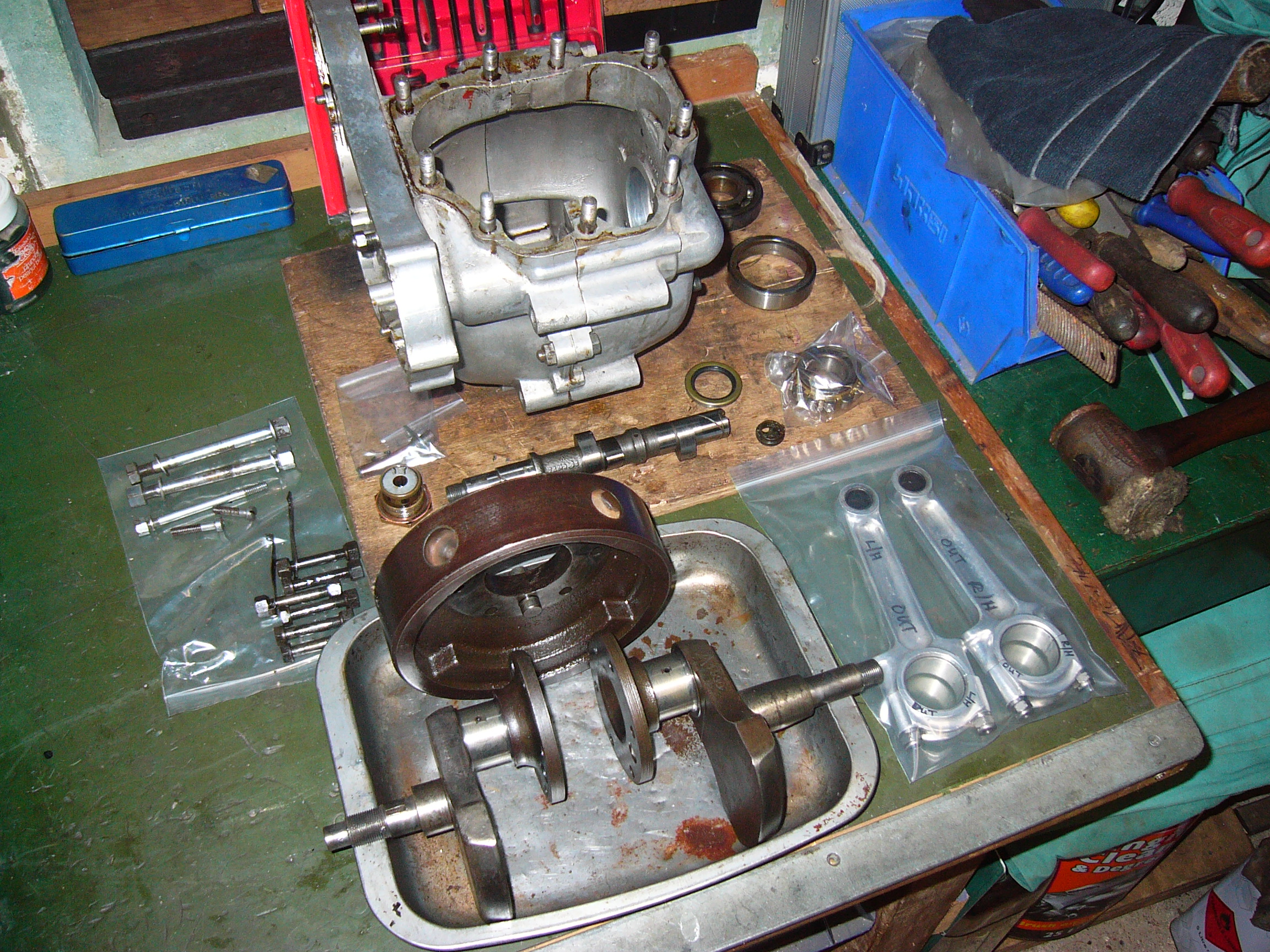

Despite reading everything I could I cant find any real descriptions or photos as to what they actually are or look like. I realise one pumps more oil and can do more harm than good but how do I know what has been fitted to my 59 ` Dommi 88 ? Do I have to remove the worm gear to check and clean the pump if so any advice on how to do that ?

Thanks guys . I actually have the whole motor apart and going through everything . I thought I had bought all the right books/manuals but the occasional things come up when it`s better to " if in doubt ask` ! Got to admit i`ve learned loads but a little disappointed that this motor was supposed to have been rebuilt and so far i`ve had to repair or replace most things .
you have joined the large group that discover the term ‘rebuilt’ could mean almost anything…..!
