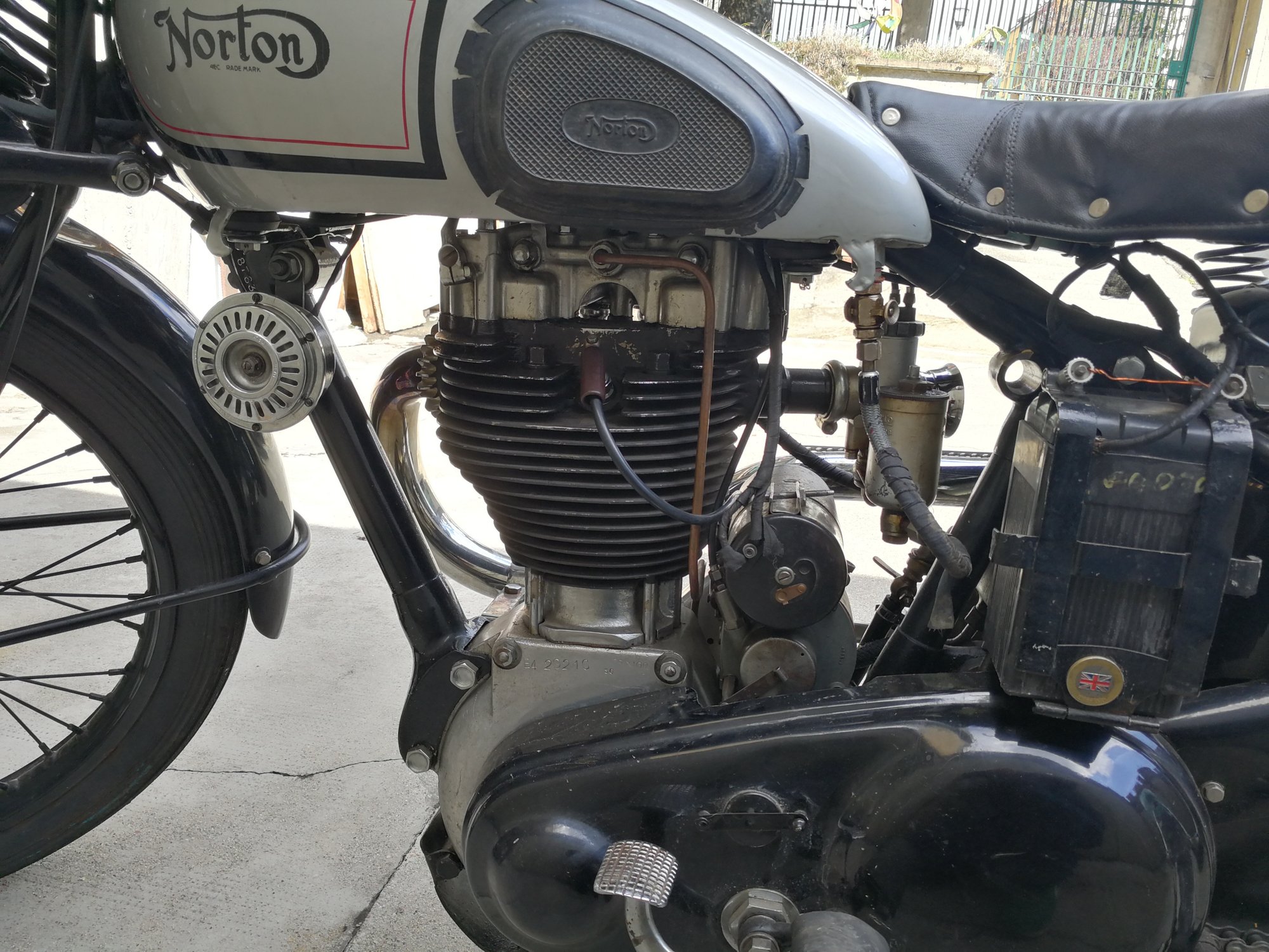

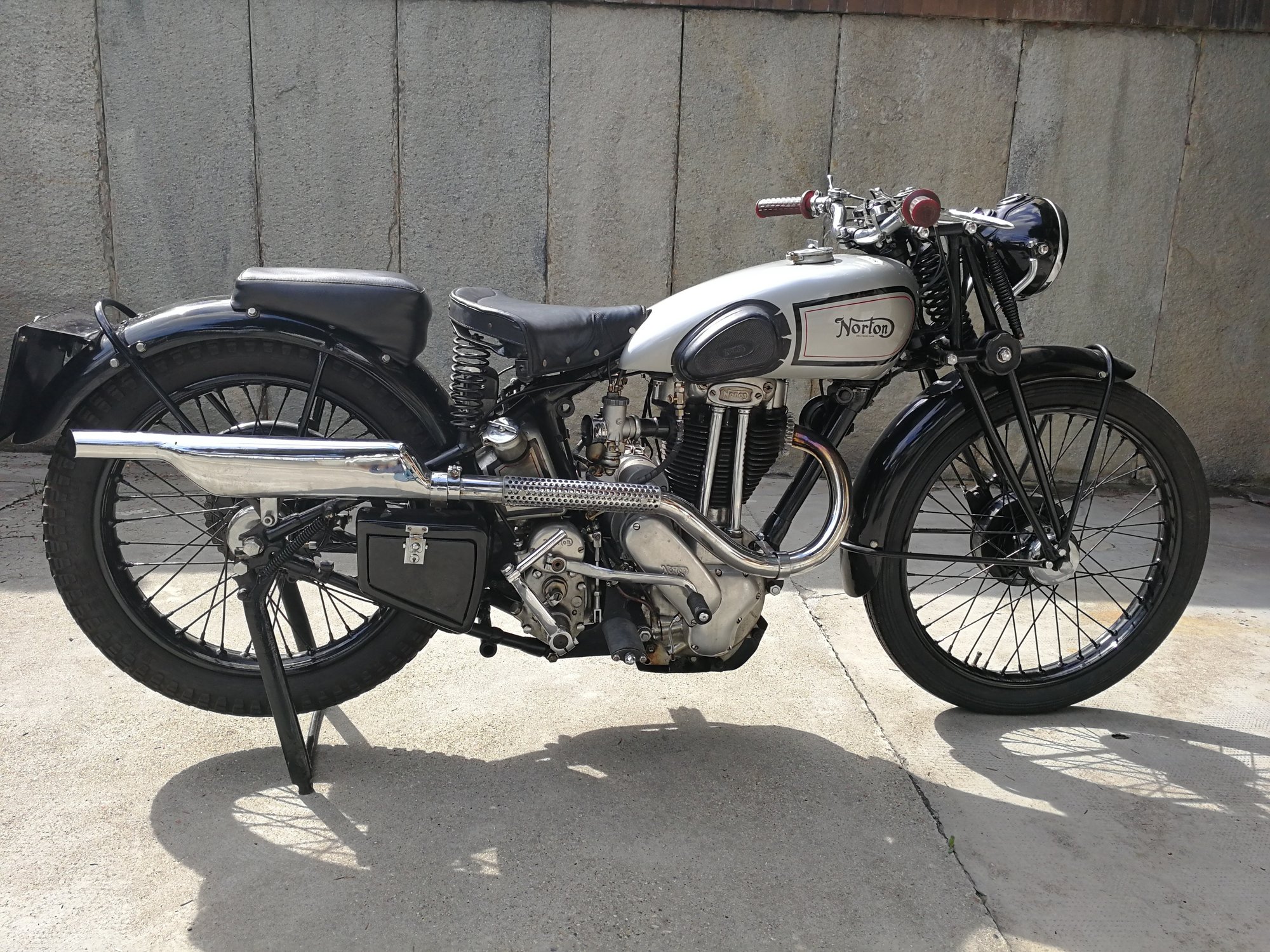

Hello, recently I bought a Norton ES2 Trials specification of 1938, number of frame 87637, I'm looking for more information about the model.
attached some photos.
Best regards
Model Type
Any late 1930s Norton could be ordered to Trials Specification.
The ES2 of this era however always had a full cradle frame. A 500cc single-port OHV in an "open diamond" frame would be a Model 18.
The open diamond frame from 1937 onwards featured horizontal saddle spring lugs intended to lower the saddle height. The frame photographed here is either 1936 or earlier, or perhaps a WD16H frame as they continued with the vertical mounts until 1945.
Wheel hubs here are the up-to 1935 type.
Model Type
Richard is correct, on the face of it this looks like a 1936 Model 18 with a later engine. The Model 18 or ES2 of that vintage would have had open valves. The ES2 and Model18 engines are interchangeable.
The NOC Records Officer will be able to date the frame, engine, and probably gearbox and forks from factory records. It is common for a bike this old to have needed a replacement engine at some time in the past, or perhaps someone may have decided to upgrade to an engine with enclosed valves.
The E4 prefix on the engine…
The E4 prefix on the engine no. makes it a 1950 ES2 engine
